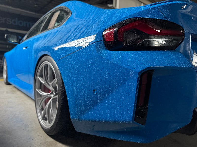

Full Coverage PPF Strategy
I went with Suntek Ultra PPF for complete vehicle coverage. Half measures don't make sense on special order paint.
Coverage Areas:
  • Full front bumper, fenders, and hood
  • A-pillars and roof
  • Door edges and handles
  • Rear fenders and bumper
  • Trunk lid and spoiler
  • Side mirrors
Full coverage eliminates the visible line where protected areas meet unprotected paint. Suntek Ultra provides self-healing properties for minor scratches. Heat from the sun makes surface scratches disappear.

Ceramic Coating Over PPF
Nanolex SI3D Cerabide HD ceramic coating goes over the PPF. This layered approach provides multiple levels of protection.
PPF handles physical damage from rocks and debris. Ceramic coating adds chemical resistance and makes maintenance easier.
Ceramic coating over PPF provides:
  • Enhanced gloss and depth
  • Easier cleaning and maintenance
  • Chemical resistance against bird droppings and tree sap
  • Reduced water spotting
  • UV protection for the film
The coating bonds to the PPF surface, not the paint underneath. When the PPF eventually needs replacement, the ceramic coating comes off with it.
