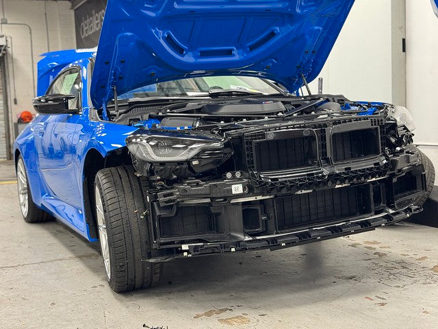

The S58 engine tolerates modifications better than most modern BMW engines. That doesn't mean every upgrade delivers value. Too many builds sacrifice reliability chasing dyno numbers that don't translate to real-world performance.
I focused on upgrades that improve airflow, manage heat, and enhance driving dynamics without compromising daily usability.

Heat management determines how long you can maintain peak performance. Track sessions expose cooling inadequacies quickly.
Primary Upgrades:
  • Eventuri carbon intake system
  • CSF engine oil cooler with rock guard
  • AutoTecknic dry carbon fiber cooling shroud
The Eventuri intake provides measurable airflow gains while adding visual appeal. Carbon construction reduces weight where it matters for front-end balance.
CSF's oil cooler addresses the S58's tendency to heat-soak during extended high-load driving. The rock guard protects against debris damage. Prevention costs less than replacement.
