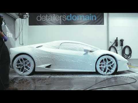

This Lamborghini Huracan was coated about 6 months ago with a ceramic coating, we wanted to test out the ability of the Sonax Spray and Seal and the effects of it over the coating. We are happy to report that it worked extremely well. Sonax Spray and Seal was compatible and showed no issues or side effects with the ceramic coating. We would recommend it as a maintenance product over your cars protected with ceramic coating.
