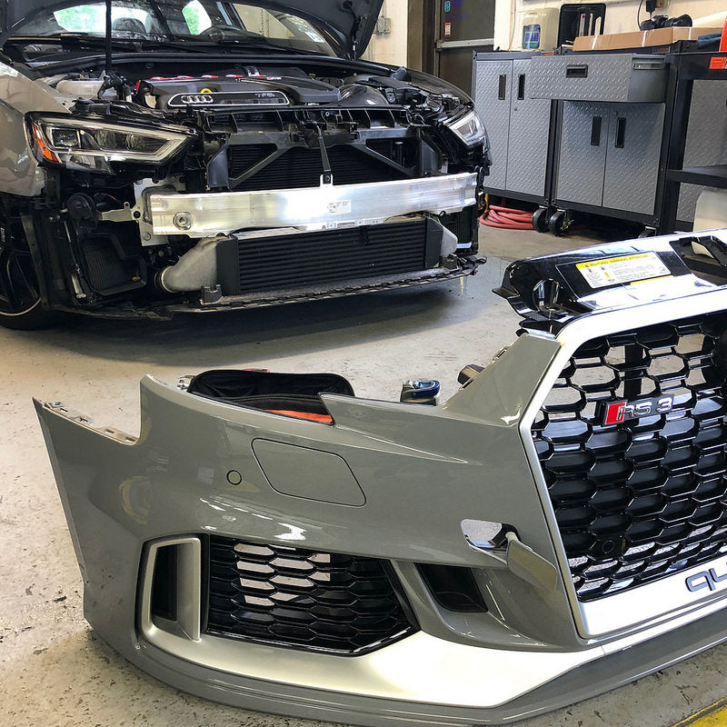

Not much to say about this but the intercooler is much larger than stock and it was a logical upgrade to get consistent power.  Retails for $999.99 and took about 2.5-3 hours to install.
Stock vs APR
