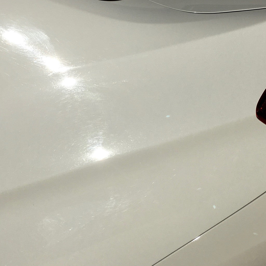

Imperfections
Severe flaws in paint
50/50 shot of the piano black trim on the BMW. Light scratches are quite common on trim like this, faded and dull, we fixed it using Menzerna SF4500 with an Uber Green Pad
50/50 shot of the rear quarter
50/50 shots on the paint
